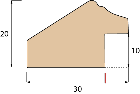

Just measure the actual length you need to cut rather than the glass size and then mark it on the moulding.
The actual length is the glass size plus the length of the base of the moulding x 2.
In this example image the length of the base of the moulding is from the back of the moulding to the red line and will be around 24mm.
