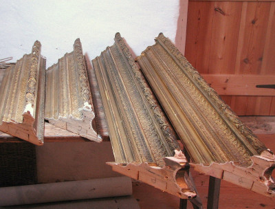

A customer gave me this frame to re-size so that painting he has will fit inside.
The canvas is 2" longer than the rebate but 4" shorter on the height.
You can't just break these frames open at the mitres, they are built like doorways. The only way in is to saw and hacksaw it apart and then start digging out the deep hidden cross nails.
Why do people keep giving me these monsters? They weigh a ton and are a huge effort to lift and move around.
But at least it is fun and a challenge.
The plan is to cut away some of the inner flat section so as to widen the sight size, re size the rebate, re-cut the mitres, join it up and make good all the loses etc.
'Trouble is the moulding is 8" wide and my saw will only cut up to 4", so I may have to run each length through the rip saw using a thin kerf blade and at a selected point in the decoration.
Then mitre each piece again, glue them together and make good the now very wide mitres.

If I had gone for cutting it down the middle, that still would not have given me access to the engaged slip. All the frame elements are well glued together so there was no way of removing it. To increase the sight size of the frame I have to reduce or remove that inner slip.
And I have no way of accurately cutting the frame in half, as well as the problem of re-joining the lengths and making them mechanically strong enough to support the weight of the frame.
If I can re-make the mitres well enough, then I can use long sunken dowels drilled into the corners and filled.
There is 2" spare at each end of the short lenghts and I have been cutting into these and not through the original mitres.
You are following I hope.

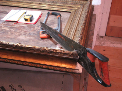

I've opened up the frame and just as Frutini had predicted, it was rammed full of metalwork.
The wood saw is a bit the worse for wear but the hacksaw get me through 'till the end.
I got all the nails out by drilling alongside each with a 2mm drill bit and once loosened, pulling out with long-nose pliers.
Nails driven into the sides were knocked back out with a hole punch.
It's all a bit messy but can be easily sorted later.
Now I've got access to the front engaged slips and will be able to reduce the profile width to display the larger canvas.
3/4" needs taken off but removing it from the front might spoil the symmetry of the profile, so I might go deeper into the contours, remove a larger piece and fashion a new sight edge and inserted slip.
I've dismissed my original idea of splitting the moulding into two pieces so as to fit the double mitre saw. It would be easier to build a super-accurate mitre box and buy a new quality handsaw from Screwfix.
