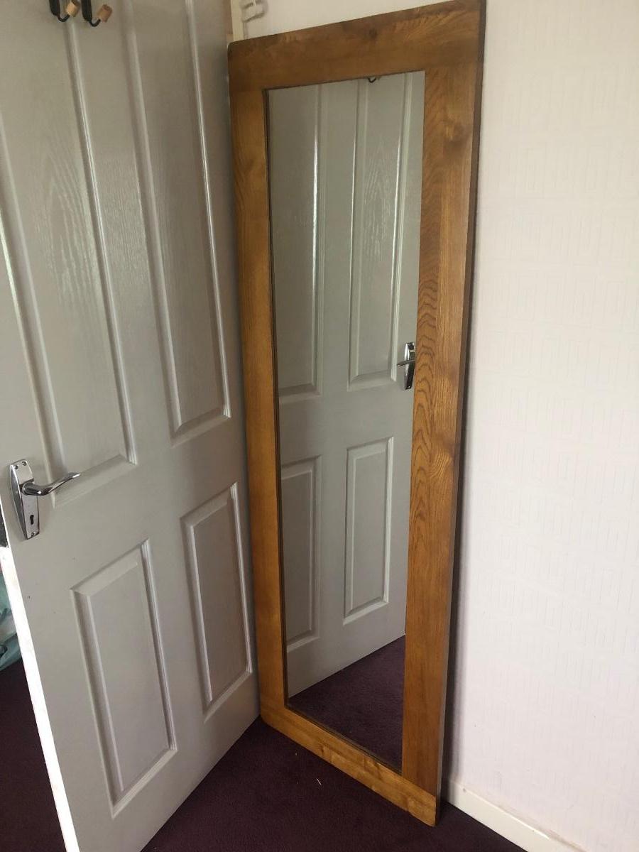

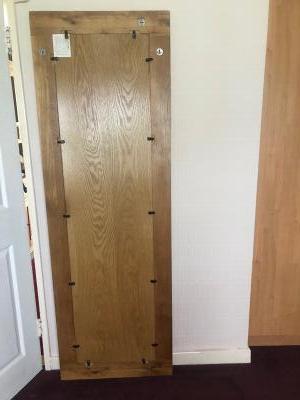

I’ve had plenty of mirrors in for repair and have seen a lot of overkill, like being stuck in to the rebate with mastic, then the backing board being held in with quadrant moulding nailed and glued to the rebate, huge screw rings and wire like a coat hanger, etc.
Here’s one I used to have, solid oak frame and backing - held in with turn buttons, albeit pretty heavy duty ones.
I would just use framers points and foil tape. I’d make sure the rebate was filled to put the backing as close to the wall as possible though. If weight is an issue use correx. Two pieces bonded together with the flutes going perpendicular makes for a very strong but lightweight board.
Mirrors are best flush to the wall, so maybe not wire. Z bars are good and could go top and bottom, then there are strap hangers etc - mine as you can see used keyhole hangers which were fine but take very accurate positioning of wall fixings.

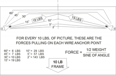

Mirrors are best not hung with cord/wire (or whatever a “cable” is!) due to it tipping forward.
If you must use that then please use TWO wall hooks, with the angles between them and the frame hangers at sixty degrees.
This should apply to most frames
Here’s why
Here’s why

Imo opinión every Framer should have that diagram printed out and kept somewhere handy as a reminder and to educate customers who are hanging heavy pieces.

The idea of simply putting two wall hooks (I slap myself for not even thinking of it) is of course a much better solution to reduce the lateral force
Excellent ressource, and I like the simple "rule of thumb" calc.

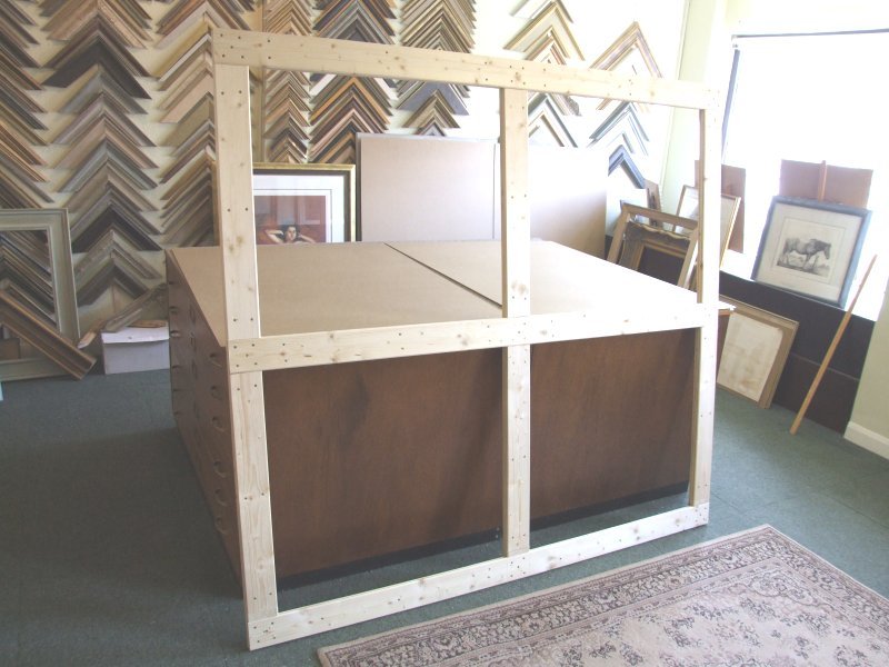

Sometimes you have to abandon conventional thought when it comes to weighty frames.
I came up with this concept many years ago for mirrors....
Make a sturdy subframe the size of the mirror. You can engineer a cleat system into the subframe and attach a
batten to the wall with as many fixings as necessary. This way the outer frame serves only to keep the subframe
and mirror together. I have a full sheet (4x3') mirror on my bathroom wall with a ½" wide beech moulding around it.
It's solid as a rock and is perpendicular to the wall.
I found t&g pine cladding the most economical option. Rip the 'tongue side off and you have a 100mm x 8mm plank.
If you use two layers you can form half-lap joints and add cross braces with no fancy woodwork methods, just 90º cuts
and a bit of gluing and screwing. The resultant frame is very strong but fairly lightweight.

Cor, this looks sturdy indeed. Sounds like an excellent option for the big mirrors. Thanks for showing me this layoutprospero wrote: Fri 07 Mar, 2025 2:11 pm Sometimes you have to abandon conventional thought when it comes to weighty frames.

That one was close to 6ft square. Not for a mirror but a big map. It did get quite a hefty frame on it but
it could have had a very narrow frame and still have been solid as a rock.
The weak link with hanging heavy frames is usually the wall attachments. I like big hammer fixings when going
into brick. But the thing with cleat fixings is you can wack in as many fixings as you like and the weight is distributed
along the length of the wall batten.
