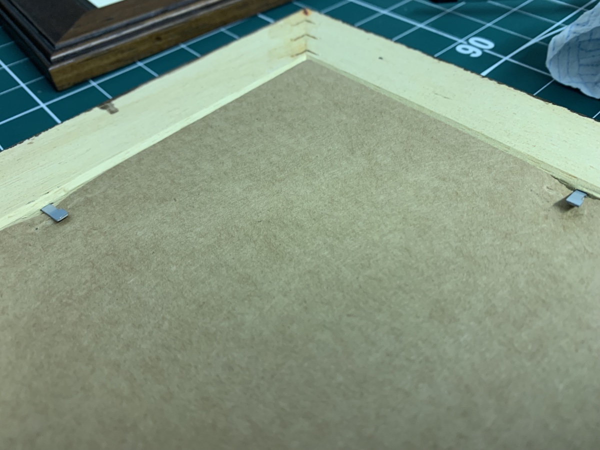

Hi All,
Another fundamental one I should already know, so be gentle...
For the first time today, I struggled a little with fitting the assembled layers into the depth of the moulding. No biggie - it just meant that the points had to be inserted at an angle and therefore protrude out at an angle. See these pics.
So, I guess the easy answer is to be more selective with my backing board. Do you folk keep thin backboard for this reason? Or even vary with backboard depths?
Overall, does this problem really matter all that much? Or is considered imperative the points aren't protruding out, for fear of wrath of the Guild?

Re: Maintaining Depth at Assembly
"the wrath of the Guild..." or a professional finish? Maybe they're the same.
I don't think this looks very professionally finished.
Alternative techniques are available. You could use round head staples to fix the backing, which will be fired at a angle through the backing board and be flush with it. This requires the expense of a compressor and a round head air staplegun.
You could also glue and nail some mitred bare wood spacer to the back of the frame which would give you an additional 5mm of depth,or cut down some bare wood moulding offcuts to the required depth.
I don't think it's a question of your backing board being too thick (it's produced to that thickness for a reason), it's a question of your moulding not being deep enough to accommodate your sandwich. The simple solution is to extend the depth of your moulding to accommodate the sandwich.

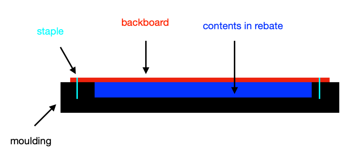

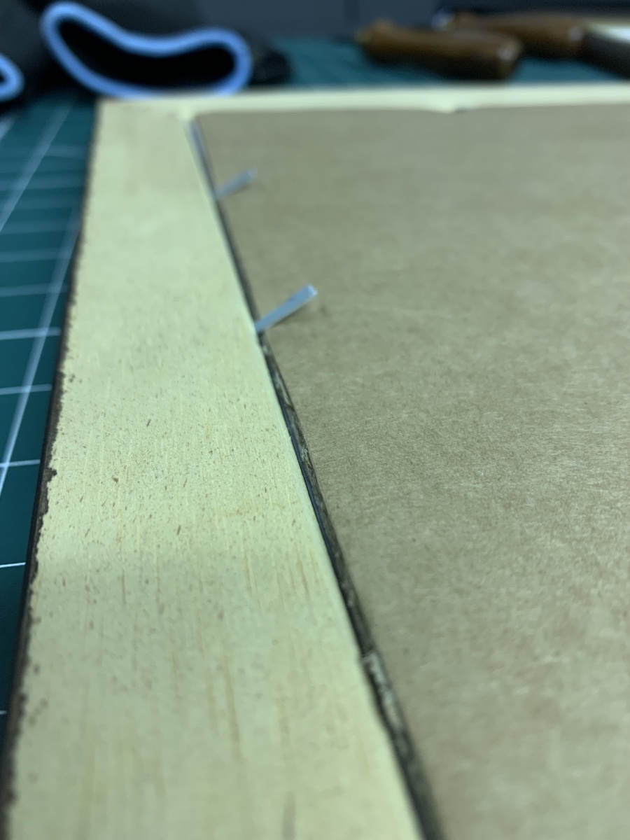

One solution would be to staple the backboard to the moulding instead of fitting it inside the rebate (obviously a bigger piece of backboard will need to be cut). The moulding has plenty of width to enable you to do that. Equally obvious but I'll say it anyway, is to make sure the depth of the staple is sufficient to bind it to the moulding but not so long as to protrude out through the face of the moulding. Then finish off with your choice of tape to cover the staples, I prefer gummed tape. Use tabs in the normal way to hold the rest of the sandwich within the rebate.
I would use more tabs than are shown in the image, particularly closer to the corner, but not too close. Otherwise you could find the corner lifting over time.
Has the wood split? If it has, it's possibly because the tabs are too close to the top edge but it's not clear from the photo whether that's the case.

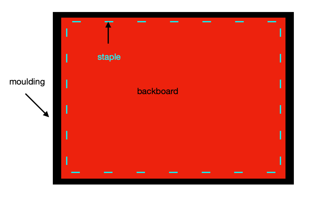

Occasionally I've created a smidgeon of space within the rebate by using a barrier sheet instead of an undermount, in which case the art would have to be attached to the top mount. Every little helps, as they say

Hi Justin. I walked right into that one, didn't I? Sloppy use of prose.Justintime wrote: Sun 26 Jan, 2025 2:41 pm "the wrath of the Guild..." or a professional finish? Maybe they're the same.
I agree, it doesn't look very professional, and would be uncomfortable sending out to a client (the example in question is one of my own pieces, so I can afford to let it slide this time).
I do like the solution of building out slightly, using spacers, so this might be what I aim to do in future. The moulding in question is quite narrow, but not unusually so, so I imagine this is a regular problem for many framers.

Hi Rainbow. I must admit, I'm struggling to visualise the stapling solution you're suggesting. I'm going to pursue some videos tonight to better review this option.Rainbow wrote: Sun 26 Jan, 2025 6:20 pm One solution would be to staple the backboard to the moulding instead of fitting it inside the rebate (obviously a bigger piece of backboard will need to be cut). The moulding has plenty of width to enable you to do that. Equally obvious but I'll say it anyway, is to make sure the depth of the staple is sufficient to bind it to the moulding but not so long as to protrude out through the face of the moulding. Then finish off with your choice of tape to cover the staples, I prefer gummed tape. Use tabs in the normal way to hold the rest of the sandwich within the rebate.
Good point about the wood splitting: yes, the wood did split slightly on at least one of the points. Thankfully, not too badly, but that was one of the other red flags that signalled I need to better prepare for this issue in future.

Do these drawings help?RobM wrote: Mon 27 Jan, 2025 2:09 pm Hi Rainbow. I must admit, I'm struggling to visualise the stapling solution you're suggesting.

They're very helpful! Thanks for putting those together.Rainbow wrote: Mon 27 Jan, 2025 5:10 pm Do these drawings help?
Okay, so this makes sense now...the backboard covers the entire footprint, not just the rebate, and finished with staples. I can see this as a good solution insofar as it limits building out the mouldings with extra bits.
