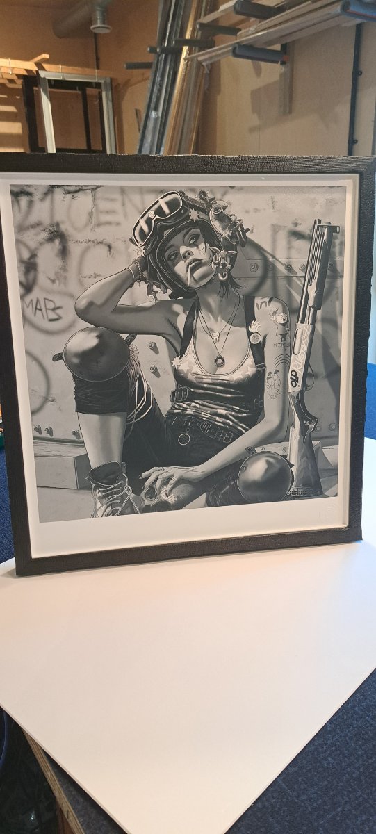

If you like playing with fire even better. Look it up. It's a process of burning the surface layer of the wood. In construction it creates a protective layer so that wood cladding is less vulnerable to damp mould etc.
In framing it's the look of charred timber. Lion's and, LJ have ranges that try to be it, but honestly it's such a beautiful and simple process, I don't know why we'd buy a finish that is far superior when it's done by hand.
The process is simple. Make a hardwood frame, slowly burn the frame surface with a hand held gas burner. Let it cool down, burn some more. Seal with two cooats of Polyvine Dead Flat Matt. I wear Kevlar/leather gloves while I'm doing it.

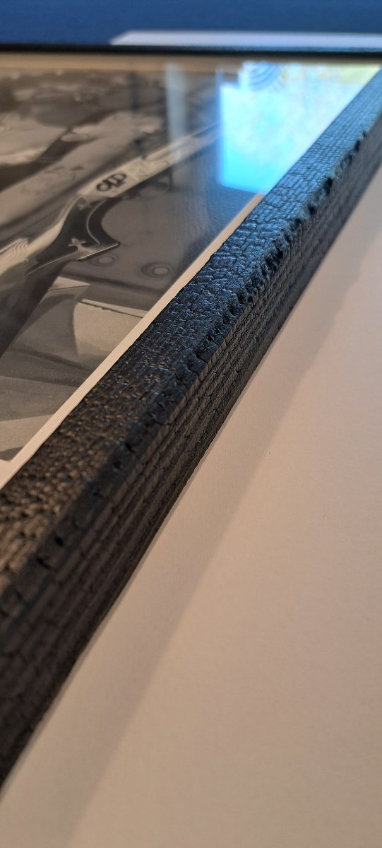

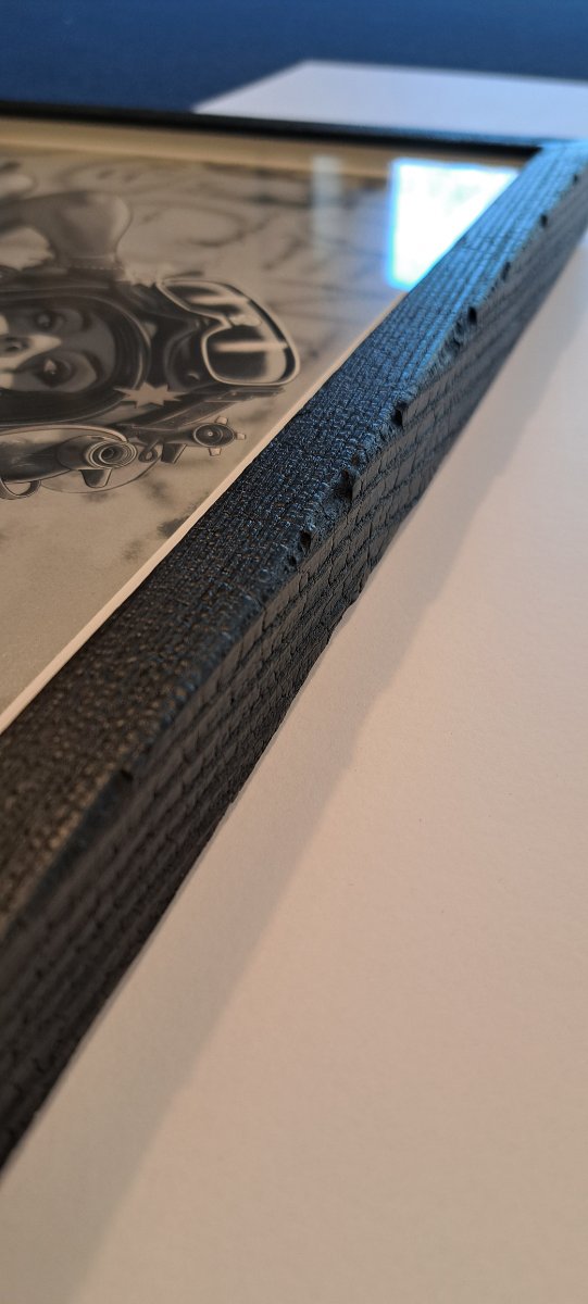

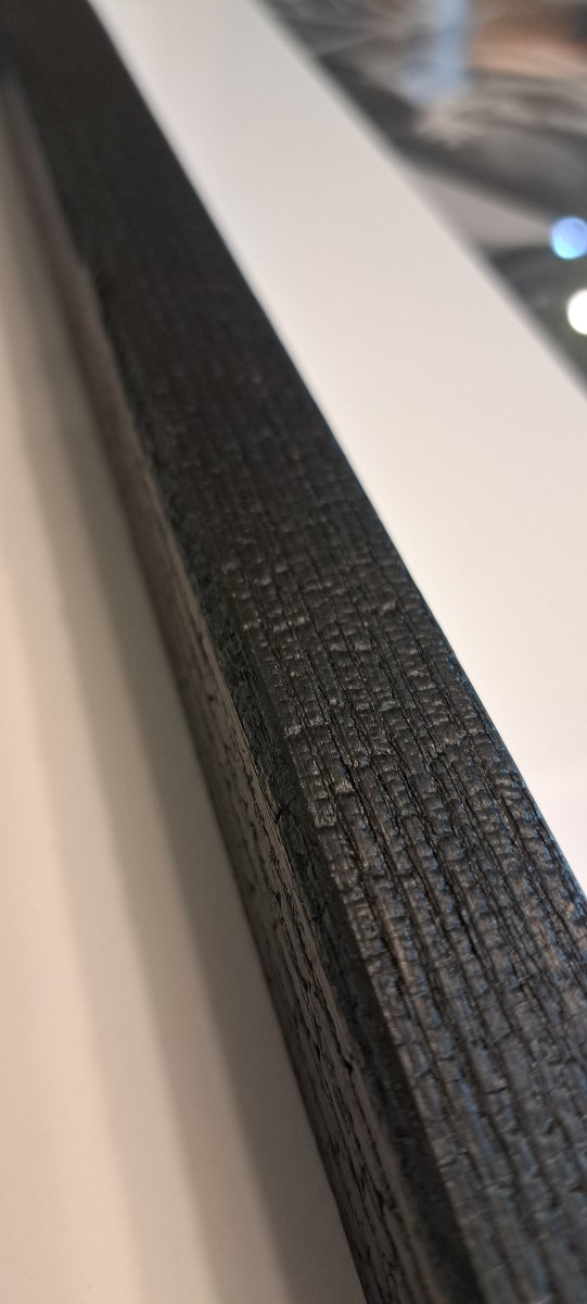

So I didn't have enough hands to take any in process pics, but here are some finished pics.
Love to hear what you think!

Re: Shou Sugi Ban
Looks good!
Is that ash?
Is that ash?
- Posts: 1498
Re: Shou Sugi Ban
That looks really good, Justin.
I too was wondering which wood you've used.
Have you tried it on other timbers?
I also noticed that most of the charring is on the outer edge. Can you control the burn like that?
- Posts: 2278
Re: Shou Sugi Ban
Thanks, yes Ash. I only gave the inner rebate lip enough to blacken it otherwise it starts to char the inside of the frame. The outer edge is good and pitted because even when you blow any flames out it carries on burning. I did give it a rub round with the glove to stop it eventually. The outside had two coats of poly vine and the bottom and inside had one just to stabilise it and stop getting black everywhere. As I was close framing the work I lined the rebate with the alu/white framing sealing tape.
