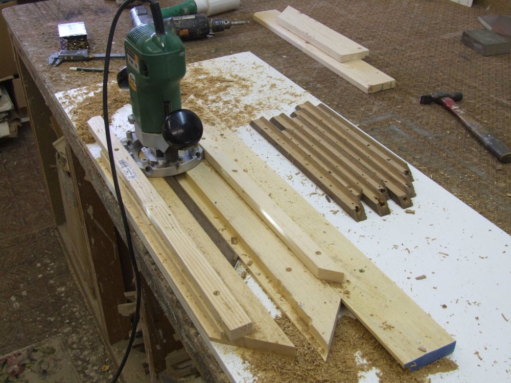

I'd go for the added slip which will increase the rebate width by ~5mm or so.
If this isn't desirable you'll have to widen the rebate with a router.
Easy enough on a router table but you can knock up a jig and do it by hand.
Here's one I did earlier...
