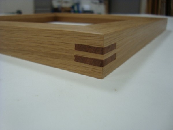

Got a De Walt machine from Axminster with 1000 free biscuits, had fun playing over the weekend
Ian

Nice job Ian,
any comments regards ease of use,time taken,type of moulding used etc.It certainly looks a neat and high end finish.
Brian

I have made this type of joint before using a router. I originally wanted the biscuit machine to strengthen the joint on some of the very large mouldings we use. Having seen the video as linked in the above postings it seemed to make a purchasing decision much easier.
With regard to how, I pretty much followed the instructions. I found it not necessary to make the jig as the machine has adjustments that are suitable unless you are using incredibly deep mouldings; I simply set it at one height. Made the cuts and turned the frame face down and did the same again
One thing to note that when sawing the wedges off you must use a specialist flush cut saw any standard saw will destroy the frame.
With regard to moulding, any natural frame can be used as long as there is a sufficient thickness. I used Sepele wedges to show the technique in contrast, but any combination of woods could be used depending on the effect required Remember to make sure the grains cross or the joint will be very weak.
One last point. I underpinned the frame first if you do work out where the cuts will be and keep the nails well clear, you really don’t want to hit them with the saw blade!

I have used these joints for a couple of years. The method descibed using the biscuiter is called a Keyed Mitre. I've been doing them on a router table, but having seen that jig for the biscuiter it looks less cumbersome - try routing a corner of a 4'x6' frame where you have to move the frame against the table and you'd see what i mean!
FWIW i have a very cheap biscuiter - £50 from Screwfix. Its branded as Erbauer - Screwfix's own pseudo-German branding for their cheap Chinese power tools. It makes the most appalling sound as the motor is rottenly cheap, but it does the job ok. I always buy good quality power tools when i can afford them though - you really do get what you pay for

Forgot to mention - i use keyed mitres for thin closed corner frames(for fat ones i use a conventional biscuit) - it is the best way I've found of stopping the paint cracking over the mitre

Yes that was the problem I had. Only real disadvantage with the biscuit machine is the cut depth is limited, so the corner I did is the maximum size possible, would be nice to make the keys longerframejunkie wrote:try routing a corner of a 4'x6' frame where you have to move the frame against the table and you'd see what i mean!
