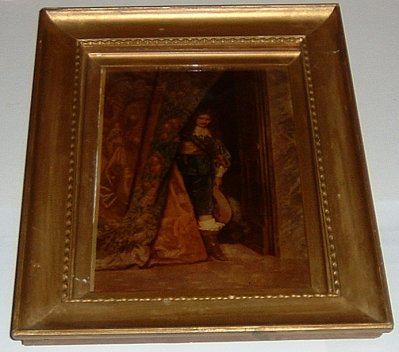

The first photo shows the item and frame. The frame was falling apart at all four corner mitres and I have already corrected this, but there is still some damage to fill and the frame will be completely re-finished to exactly match the original finish.

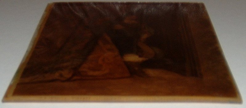

The second photo shows the glass removed from the frame. The glass is covex in both planes and has the greatest degree of curve showing at it's centre where the deviation from flatness is perhaps as much as 10mm. Sorry it's not such a clear photo, due to reflections of the back of our sofa.

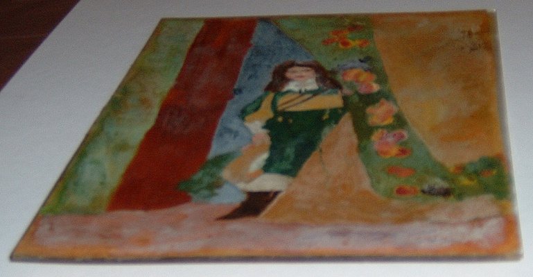

The third and final photo shows the reverse face of the item. The media used to pigment to back is very highly matt all over and show no signs of any loss of pigment or damage. I have never seen one of these before and know very little about it at all.
