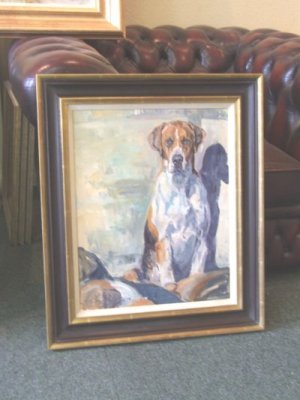

Here's one I did earlier....
Looks OK I think. It's a limited edition giclee on canvas.

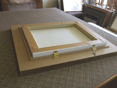

Here's what it looks like at the back....

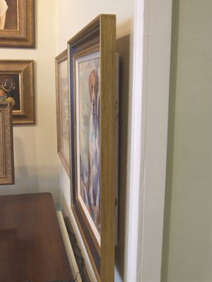

And hanging....
That I am not so keen on. The canvas protrudes a good inch. I fixed it in place with bendy plates and secured with a small screw. This works fine with with a wider frame but this fame is less than 3" and the side veiw looks untidy. I can see it being a problem with some buyers.
I pointed this out to the artist whos work it is and we agreed that the simplest way is to restretch on std bars. BUT. the sizes are metric. Cost of restreching is one thing. I don't know ehere I can buy 400mm and 500mm bars 'off the shelf'. Custom made I can see the job costing the artist £60+. I can add a thin piece of timber to make the sides of the frame deeper. This is tricky and would add a similar amount to the frame.

btw. The second picture. I didn't put the masking tape on the back. It was already on :wink:
