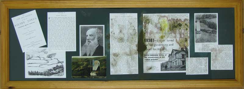

Here's one I did last year. Before:
and after:
Thankyou Photoshop.
