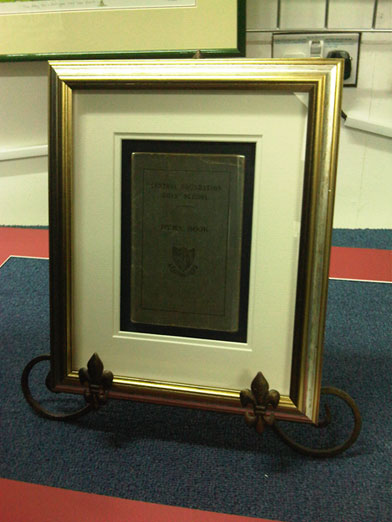

Well I took Roboframer's advice and looked at Jim Miller's book 'Mounting objects with clear film', it has been on the shelf for a year or so, what a lot of useful tips in there. I have'nt done the LP yet but thought I would create a Mylar wrap around an old hymn book someone brought in recently. I'm really pleased with it, the book is totally protected and the mylar strips are secured through slits in the mat board,
very neat indeed, I'll be using a version of this on the LP :clap: Here's a photo of it.

That looks really good. Can you see the Mylar through the glass, it doesn't show in the picture?
Bagpuss
Posts: 848
Interests: TBA
Re: Framing signed 12inch LP sleeve
Post by Bagpuss »
AllFramed wrote:That looks really good. Can you see the Mylar through the glass, it doesn't show in the picture?
I think if you were looking at it for the first time it wouldn't be that apparent but once someone pointed it out you could. In this instance it worked really well, I have done the mylar pouches before for old photos, letters etc., but this is the first time I've used this wrapping method. :D

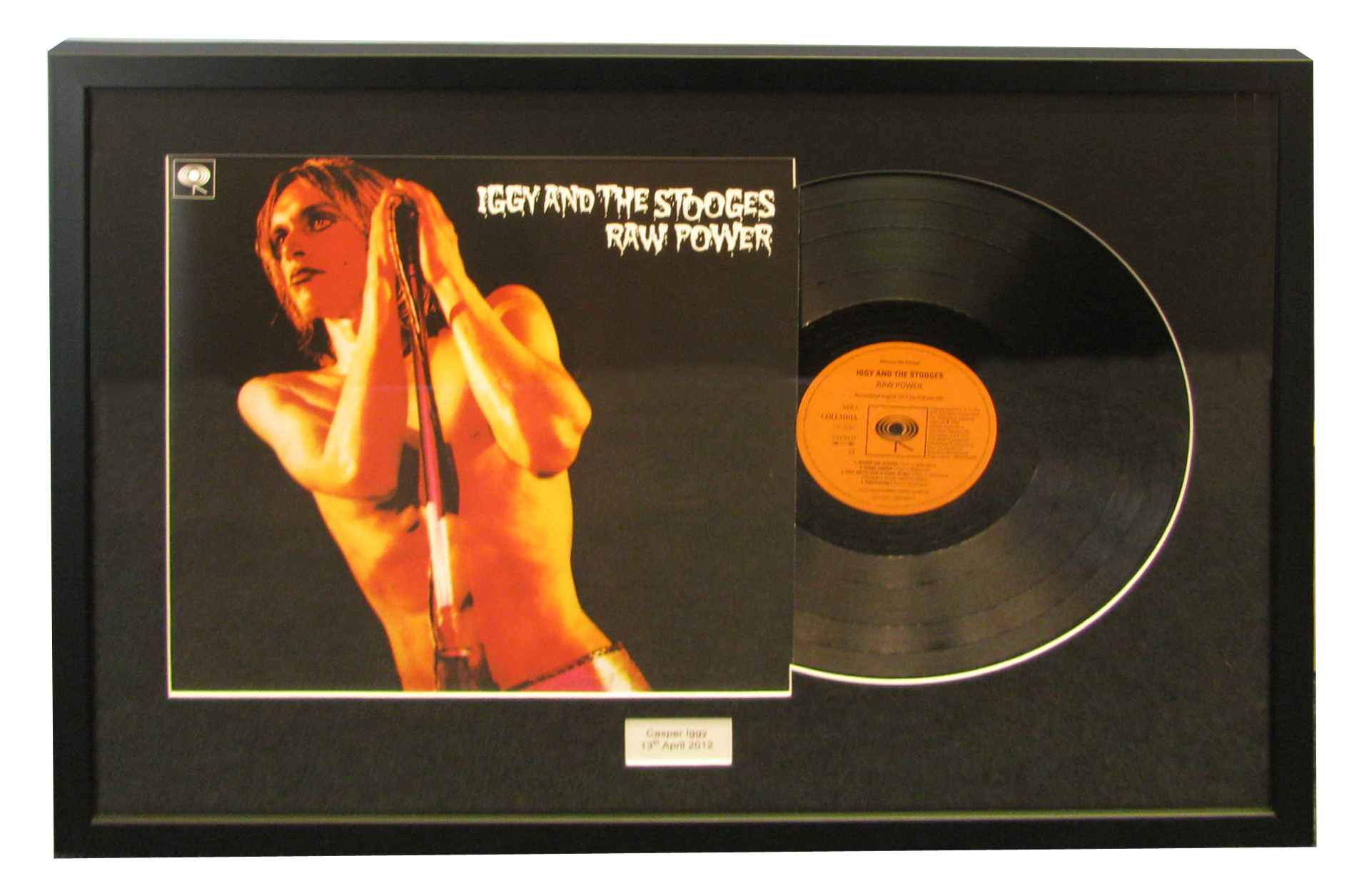

Post by Steve N »
we do them with sink mounts, we have done around 30 like this for one client
