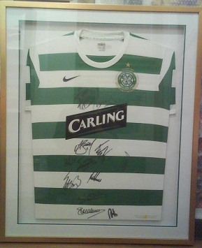

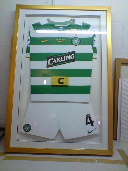

I make my template out of mountboard, and to secure the top i use tapestry tape, which is (if you dont know) a VERY strong double sided tape. I always make sure the customer is aware of the method. the tape goes on the back of the template.
1. I have never had anyone complain
2. I have never had one back
I am aware that there will be those of you who might think using tape for this is wrong, and not fully reversible, but as i have said i have never had one returned either to repair it or to take the shirt out so someone can re-use it :lol: .......which is very very unlikely.
Once i have stretched the top i secure it to the backing board with a few 8mm staples through the template (below the neckline,out of sight),
once you are at that stage its just a simple frame, glass+backing, a double mount and some strips of foamcore.......dead easy :D
I must have done in excess of 300 of these over the years.......I have changed my method quite a few times, i used to sew these but never got the shirt tight enough, and after looking at the tac gun i knew i would never use one of those.
here are a couple of pictures.....very poor quality though as taken on the phone and never intended to show them really :lol:

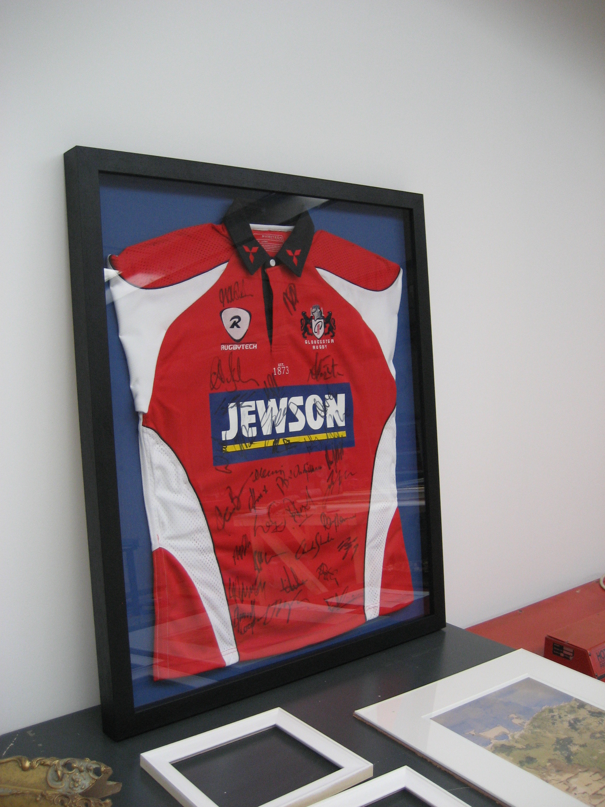

Here's one I did earlier, using a 5mm foam-board template, pinned with T pins at the back and secured th the undermount by threading fine, strong wire, top and bottom through foam-board shirt and undermount, knotting and taping at the back. Very secure.

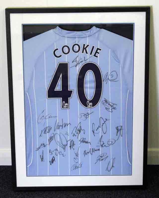

I use 5mm foamboard cut to shape, pins along the bottom and sew the sleeves lacing style to stretch reasonable flat (not drum tight). Anchored to back board which is a complimentary coloured mount board with loops of thread sewn with a curved needle. 10mm of foambaord between front and back mounts to give some space and a double mount at the front using a colour from the shirt (or as near as poss.) as the inner. Deep rebate moulding, most commonly black.
I charge £150 minimum(non negiotable) and am not interested in doing cheaper low spec jobs.
Here is one from a little while ago:
