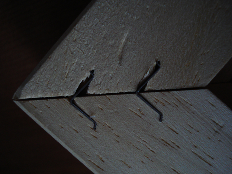

Hi all,
I'm pretty much totally new to framing and am struggling to get the results I want when making the frame itself. I'm using a mitre trimmer/guillotine and an old Kimberley manual underpinner/mitre vice. The problem is that the mitres seem good and I can get the two pieces of moulding to fit tightly together in the underpinner/vice, but after I drive the wedges in and release the moulding there's always a hairline gap in the joint. It's been suggested that this may have something to do with the need to use the right wedges for soft or hard wood, and also that hard wood is generally difficult to work with, but I'm still struggling. The mitres seem good but maybe they're not perfect - maybe the trimmer is rolling the wood or something?
If anyone had any advice on how I can get past this problem I'd be hugely grateful.
Many thanks in advance.
David

Here's some photos of what I mean.
thanks
David
thanks
David

Move your front wedge much closer to the front (rebate), about 5mm in , are you using glue?......if not then pva wood glue is needed. Don't stress too much as i have seen much worse results from so called pro framers

Two observations:
The mitre looks to be a bit off – tight on the outside, but slightly open on the inside. This has been discussed many times here, a search of the forum will yield lots of good advice.
While the inner wedge is aligned correctly, the outer one is quite a bit off, the apex of the wedge does not lie on the join. Perhaps your underpinner can be adjusted to correct this.

No-one's mentioned that the wedges have bashed great chunks out of one side of the mitre but not the other - not that I've got any explanation or cure, but I once had a (foot operated, strip fed) manual underpinner and it didn't like profiles like this much and it didn't like hardwoods at all!
Do you get the same problem on a wide, flat pine batten? It's always good to have something wide and flat around to calibrate your chopper/underpinner with, and if all's well with that, then sometimes you just have to write the problem moulding off as unfriendly to the machinery you have - and plenty of mouldings come under that category even with a Morso and a pneumatic underpinner. They'd proably be fine with a double (or even a single) mitre saw, and/or a mitre clamp and good old fashioned hammer and nails (which many framers still use, in addition to more modern equipment or not) but I, for one, don't want to know about those, I want to go 'chop chop chop' and 'thump-ptsssst thump-ptsssst' Wham-Bam-thank-you-Ma'am.

It's a good point. Mike Royall, who trained me, did suggest that hardwoods are trickier and so this is example is a soft wood. Very soft, I'd say, as it was splintering in the mitre guillotine and as you say the wedges have destroyed it round the back. Admittedly not all the wedges were like this. Thanks for the info about problem profiles, I had no idea. Should I just get some square profile pine beading from a DIY shop to practice with or should I be practicing on framing mouldings?
Many thanks
David
