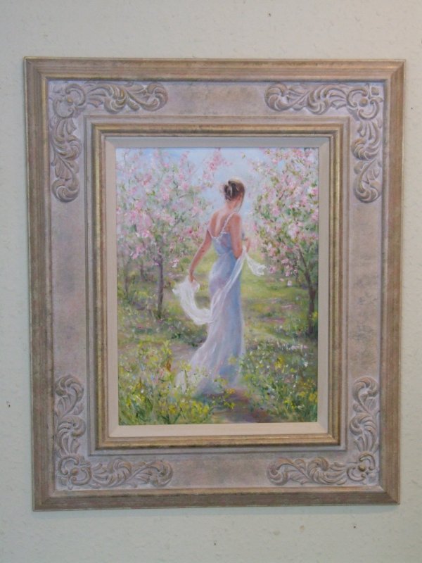

I had a offcut purge recently. Also dragged a load of (slightly damaged) readymade out of the shed. One of my artist customers likes big ornate frames, but in a light finish. So I sanded down all the frames, fixing any dings at the same time and painted them all white. Some I added extra bits to beef them up a bit. All had 1" bevel liners added. Then I gave the artist in question a list with sizes so she could paint something to fit the frame. When she had completed the painting I applied a finish to the white 'blank' to suit.
This one was originally quite a rich gold. This finish is done by dabbing splodges of dark green and pink on the white base. Followed by a light powder gilding. When that's done I painted the whole thing with white emulsion and wiped it back a bit.

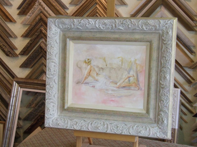

This one in particular I was very pleased with. If someone had brought this painting in to be framed I would probably have had a hard time convincing them to use this style of framing. A 4" wide heavily ornamented moulding on a delicate 10x8 painting? Wouldn't have been my first choice come to that. Just shows how 'rules' can be very successfully broken.
Well I like it anyway. :P So did the artist. :lol: Wish I could get some more of it. :(
