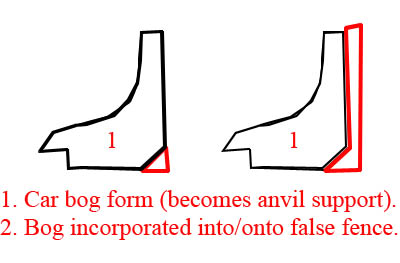

I've just setup a Jyden electric guillotine after converting it to single phase and the test pieces I used for first cutting were Chinese 20mm stretcher bar. It is a type of cedar (though the seller called it pine) with practically zero cross grain strength, so the back, back bottom edge and rebate all exhibited breakout - very similar to the framingengineer picture. My Schleicher manual guillotine cutting result on this stretcher bar was the same.
My take on this corner breakout issue is that the gesso is over-extended in its composition, so the end result is a very brittle product with little tensile strength - the binding resin has become so low in the (over-filled) mix that there is literally nothing holding it together. This is very similar to a super-fast growing tree wood, the fibre ratio is very low and the air content is high, like an over proved loaf of bread. So the bread will cave in, even under the slight pressure of a sharp knife, rather than cut.
To cut 'these weak materials,' via a knife and anvil the stress placed on the 'media' by the knives must obviously be less than the media's tensile strength, or breakout will occurr.
In framingengineer's classic picture, the fact the corner is not square is a primary issue, as it leaves the weak tensile gesso with no connection to the lower guillotine (or fence) anvil plates.
So primarily the bottom corner needs anvil support in the way of a shaped hard form that will connect to the media radius and provide support against the blade pressure. Like a female mould - that fills the unsupported gap.
Ideally there should also be minimal pressure from the blades, so a false fence may help, by moving the cut from the blade tip. Also the final cut should be reduced in size. Reducing the 'final' cut size will reduce the blade pressure against the gesso. This partial solution is easy to test by cutting the moulding over length and then cutting in to the final length with extremely light 'whisker' shaves (by moving the moulding towards the blades - not via head ratchet). Taking a whisker at a time off the moulding will likely allow the weak gesso to survive - even though corner is unsupported. Unfortunately most if not all guillotines have their head ratchets fixed, but if the ratchet could be modified to take 3 or four final whisker shaves instead of one final shave this might well work.
So in summary,
1. The blades should be very sharp. 2. The 'missing corner' needs support, on its gesso, from a matching custom made (car auto repair bog with plastic overlay should form and work fine) female 'anvil filler' strip. 3. The final cut (or cuts) need to be whisker thin for minimal blade to gesso tensile pressure. 4. Reinforced racing tape placed over the final cut area (to support the 'missing' corner) prior to cutting may also help for low volume work. Peeling it off after cutting may need due care - with pulling from the 'furthest from cut side' first. Finally, for rebate rag reduction, roughing the rebate supports and epoxy gluing false 'shoes' of 1mm alluminium strip to them, then filing it to match the bed anvils, before trimming it with a 'hisker' shave from the knives, is a great solution which eliminates rebate rag from poor distant rebate support anvils.
The above post suggests a false fence to move the cut from the tip of the blades, this is a possible solution. Ideally though the false fence should incorporate the bottom female 'missing corner' support. If there is a lot of moulding to be cut, or just a few lengths, it is not hard to make a custom 'false fence form' - via car bog in a supermarket plastic bag.... then trim it after setting.
I imagine the problem is easily solved on a saw (like Alfamacchine M400/T400) by reducing the cut speed (with the feed rams outgoing air throttle valve). This allows the 120 blade teeth (336,000 per minute) to whisker cut, though this may need some balance if the moulding is urethane and melts under even low heat of blade friction - then it needs cooling water/mist spray! Like the 'Alloy' versions of these saws have for the window industry.
I hope this post helps members find their own successful outcome.

a bead of silicone down the "gap" will last day or two and support the bottom edge.
Or warm the moulding a lot with a heat gun.
Both a pain in the ass.
So my solution is to not use mouldings that do that.

Other ideas -
Just before making cuts -
1. place moulding in guillotine and soft mark the cut region on the moulding (white board marker - or chalk/pencil) and remove from guillotine uncut -
2. then place framing tape placed tightly around the moulding at 90 degrees on the intended cut area -
3. then replace moulding in guillotine and cut through, minimise the final shaves if you can,
This works fine as the 'missing corner' support workaround! AND I only use the cheapest tape I can find...
So
= use standard framing tape as a corner bandage and cut through it!!
Try it, you'll be laughing!
So
