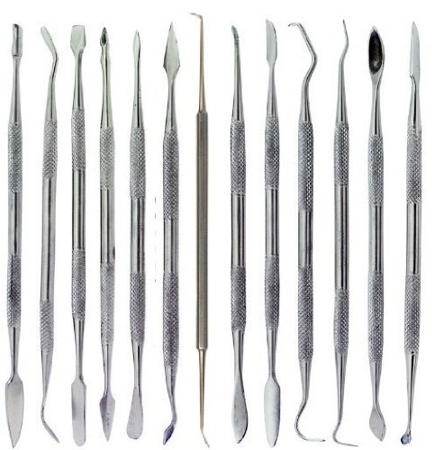

Amongst other things like 'goldfinger' and Liberon wax sticks, I've got a set of this stuff which caters for most problems like this.
For mouldings that are pain with loose foil in the rebate, I give them a vigorous brushing and then paint with diluted wood glue, it dries quite quickly.

A useful thing to have about the workshop is a set of artist's encaustic carving tools. I picked one up one day for a couple of quid. There are about ten double ended tools with a variety of points. (similar thing to what you see at the dentists. :shock: ). Great for applying fillers and general poking about.
