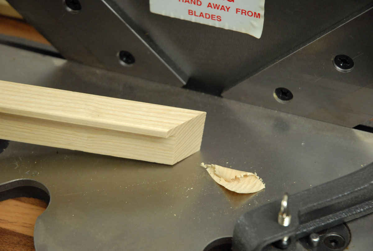

I have a hand mitre trimmer but no experience of working with polymer mouldings, but would happily cut a sample sent to me from Ricky and photograph and post results. Would it be anymore difficult than cutting ash?Not your average framer wrote: Can anyone help please?
