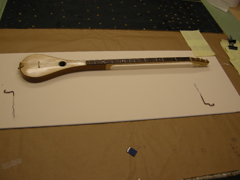

Customer wants to be able to take this out of the frame to play it. I made two formed rods from a coathanger, covered the ends with shrink tubing and painted them.
The mounting board is bonded to correx
The channels that the board is made from are handy for holding the rods, just remove the surface above one, or as many as you need. The rod is made 'squiggly' to give more purchase and is stuck in with something that dries rock hard, to prevent swivelling.
.... and that's it mounted.
Should finish this tomorrow - it's going in a slip-over frame.

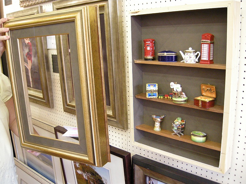

Doesn't look like I will get this finished today - anyway - here's the box that will fix to the wall with mirror plates which the outer frame will conceal. Lined with same colour board. Moulding used is the flat one you see in front of the box, but mitred on its side.
Re: Gig Stick
All done.
The mount conceals the inner box and also provides a space for the customer to store the shoulder strap.

You don't need anything, it's a very snug fit over a fair depth. The mirror plates securing the box to the wall could have washers on the bottom ones so that it tips ever-so-slightly back, but no real need on something this depth.
If there's a concern, which there might be for a shallow box, then a countersunk screw or two could be put through the top of the outer frame in to the box.
I've had this one on the wall in the shop for years and it actually tips forwards slightly.
