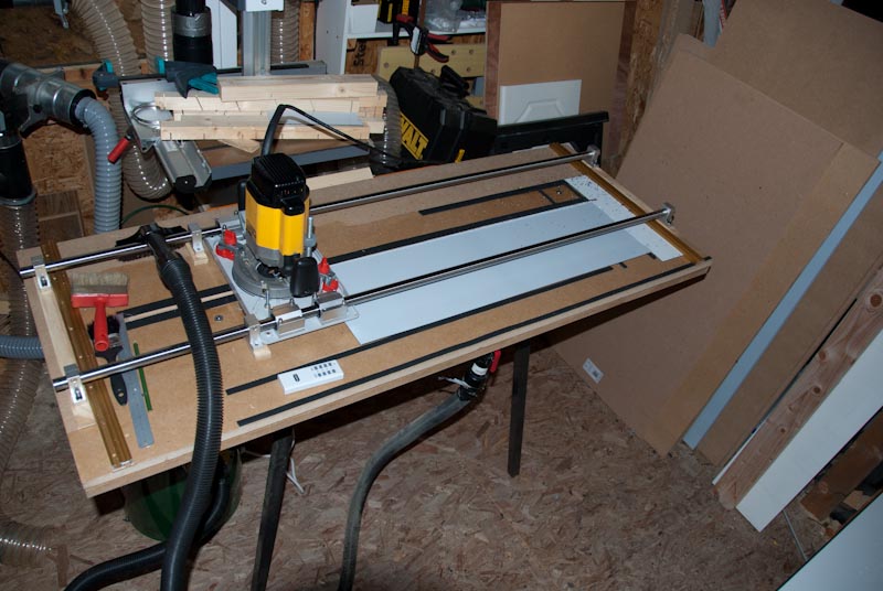

You could always build your own. I made this to cut ACP and get round the edge distortion created when cutting with the Keen Cut. The base is two sheets of sealed 25mm mdf and incorporates a vacuum bed powered by my dust extractor. Vacuum system very simple and uses neoprene strips to create small areas that are triggered by the panel pushing down a spring loaded ball bearing. Steel slide system built from CNC components on ebay. Total cost around £200 (I think) + router. More details/pics available if anyone interested.

i would be interested in your setup
what size can you cut, can you cut 1220 piece wide?
would be interested in how the thing is built etc,

The Crofter clearly does more than croft! There is some very clever thinking and fine engineering there.

Wow, That's impressive. What a nice piece of kit!
Re: Cutting Acrylic the same size as the backing
Amazing what you can do with a few pieces of wood a bit of you-know-what in the head department.
Thanks all.
Things have taken an interesting twist since I posted the picture, watch this space...!
